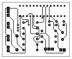

Motion Detector PCB
Layout
Qt. | References | Value |
2 | R1, R3 | 380Ω |
1 | R2 | 240Ω |
2 | R4, R5 | 46Ω |
1 | R6 | 22KΩ |
3 | R7-R9 | 1KΩ |
1 | C1 | 1µF |
2 | C2, C3 | 15pF |
1 | U1 | LM317T |
1 | U2 | PIC18F25K20 |
1 | Q1 | BC338 |
1 | D1 | 1N4001 |
1 | BAT1 | 9V |
1 | LED1 | Green |
1 | LED2 | Blue |
1 | PIR SENSOR | DC-SS502 |
1 | SPEAKER | Speaker/Piezo |
1 | SWITCH | SW-SPST |
1 | X1 | 16MHz |
![PCB layout](/circuitos/en/picture/PIR-PCB-layout.jpg)
Top
![PCB layout](/circuitos/en/picture/PCB-top.png)
Bottom
![PCB layout](/circuitos/en/picture/PCB-bottom.png)
